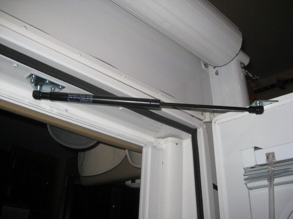

Just received a new gas charged door limiter from Carol with no instructions on how to mount it.Could someone please take a picture of their door limiter and post it. Thanks,Rick Help

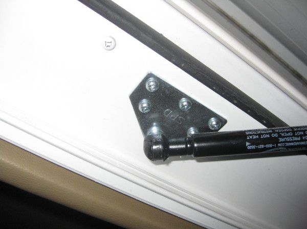

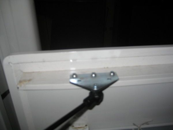

Hi Rick,
Here is the door limiter on my 2010 2551, the door stops about perpendicular to the RV so as to clear the awning mechanism.
Bob

« Reply #2 on: July 04, 2013, 04:53:40 pm »
Thanks Bob!!Great pics,I can figure it out now. Cheers
