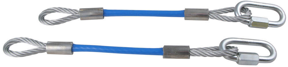

Ron D.....your set up is the exact same one i have utilized on my last two Liberty's and will use on my new Cherokee! That is excluding the wiring since i have selected to go wireless this time around.  While you have everything technically correct I notice one oversite IMO....I was told by Roadmaster that the safety cables should run all the way back to the base plates on the vehicle and therefore should not be terminated where yours are.  This protects in the case that there is failure in either of the "push in and twist" components  .  I have run small cables from where you terminated yours back to the holes on the base plate connected to the chassis utilizing high strenth connectors to accomplish what Roadmaster recommends. The new base plates I just got from Roadmaster have  and improved set up compared to the old set up (yours) in that there now are new large eyes that are right out front on the base plate recievers and very handy to hook the cables to and bypasses completely the termination hole you have chosen to use.   Just my two cents but if you think about it makes sense to hook directly to the chassis.  thanks

ragoodsp, I do utilize mini safety cables like these to bridge the area of concern.  If you look real close at my setup, one is suspended just to the left of the lock there.
You do have me wondering if I can eliminate the short ones and hook the long cables all the way to the tow vehicle.  This assuming they are long enough.  If I need just a little extra slack in the safety cables, I could add a link to each.  It would simplify things nicely and as you say, it would be a safer setup.

Ron D......Oh my lord ...I totally missed  those little devils hanging down..you are as safe as you can be and Roadmaster would be proud of you...I stand corrected.  Thanks, Ron

My Liberty's Roadmaster bracket hardware is detailed HERE.  My brackets have the holes you and ragoodsp  mention for the cable attachment of which I use the short ones as instructed in that diagram.  I just don't know if my main safety cables are long enough for direct-connect if reducing my wrap around the tow bar one less time.
