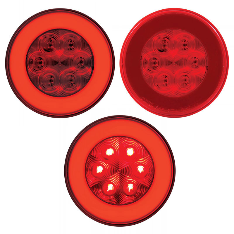

Seen these on trailer trucks, and I like this style of light - but the picture is a bit confusing. Upper left is running light, upper right is all off. Lower center is running and center brake. I really like the way the running light 'rings' look.
